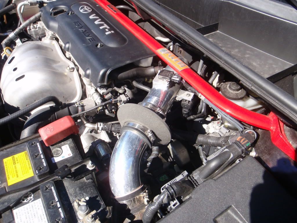

I had the hydro-lock...and installed the bypass valve without any problem (instructions call for cutting out part of the intake pipe which I did)...all I can say is unless you have a "short" CAI I would recommend the AEM bypass....flash flooding can occur anywhere or almost anywhere...and a new lower block installed will cost someone about $7K....in my case it was covered by insurance....so as a recommendation I would make sure your auto insurance covers flooding....puddles shouldn't cause a problem, but street flooding over the curbs could.

I'll check on the insurance but it doesn't flood alot out here. Do you have pics of you bypass valve installed? And do you have a trd vent?

I'm sure that you are not stupid, I was just trying to say that the installation was simple on my CAI...I have no pictures, but guess that I need to post some...and yes, I have the TRD vent installed.

i was probably too excited. anyways those pics would be helpful cause i dont know exactly where to cut...

My digital camera is down at the moment...plus I've never posted pictures (so I would need to research the process)...
On the Fujita CAI there is a break/connection in the intake prior to it turning down...there is not enough space to install the bypass at that point as it is too close to the battery.
So as far as where to cut...I removed the Fujita name plate and cut approx. 3 1/2 inches back from the sensor mounting (towards the front of the vehicle) this places the bypass about where the old air box was located...there is plenty of room so the distance is not that critical.
I just used a hack saw to cut the intake pipe being careful to make sure that I cleaned up any metal filings...I did not remove the intake, but had someone hold the intake steady while I cut...then removed the forward portion of the intake and made the second cut on it (to remove the portion that would be taken up by the bypass).
The instructions provided with the bypass have a template for just how much to cut off (about 1 1/2 inches) so that the intake remains the same overall length for re-installation.
Hope this helped...and at some point I'll try to post pictures (but, I don't know when.)

:confused: O.K. I have placed a photo of the installed AEM bypass in photobucket...I just don't know how to get it over here. I've searched the forum and still don't have a clue....yes, I know instructions have been posted before....can someone help me please....

AEM bypass installed...

Looks like this will work...AEM bypass installed.
