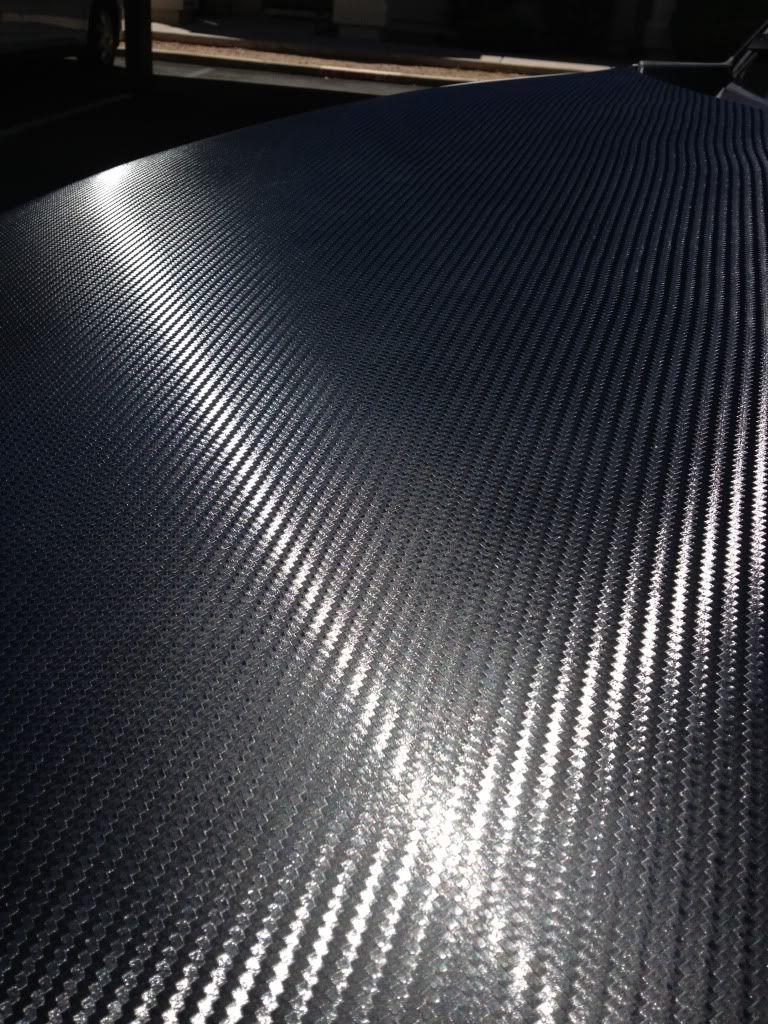

Well it still looks great. Can you take a close up photo looking along the pattern? 3M has a slight wave to the pattern,most other companies versions have the pattern in straight lines.

Looks pretty good. You might want to just use this material again for your roof. If the materials are even the slightest bit different it can be super obvious. And for that price you could do a fresh wrap every year and still come out paying less.
