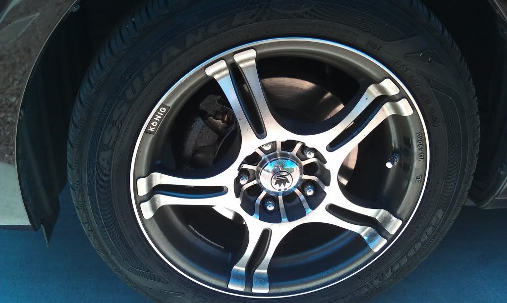

The wheel looked like this at the start.
