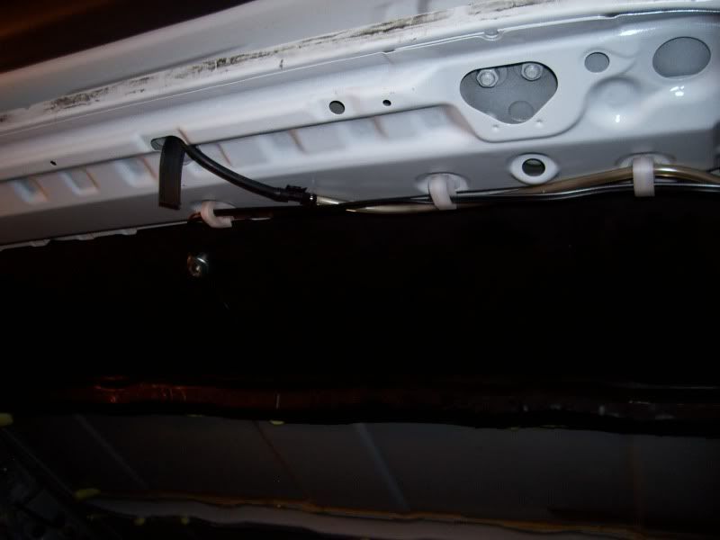

I'll start this off with a bang... I had no prior dampening on my roof, my main cross brace on the roof was broken off on each side, and I decided that the Damplifier Pro that I won was well suited for my roof.
Vid (cause we all like vids.):
That's all 4 windows down and full tilt at idle.
I began the arduous process of dropping my headliner, using construction adhesive to glue my OEM cross braces back in place, filling them with expanding foam, and ultimately applying the Damplifier Pro Black.
Pics do the talking.
Headliner dropped down, but not out.
Moving from the rear, forward.
You can see the adhesive and expanding foam mess I made. I dropped a blanket down, covering my box, amp, and seats. :wink:
It's coming along!!!
