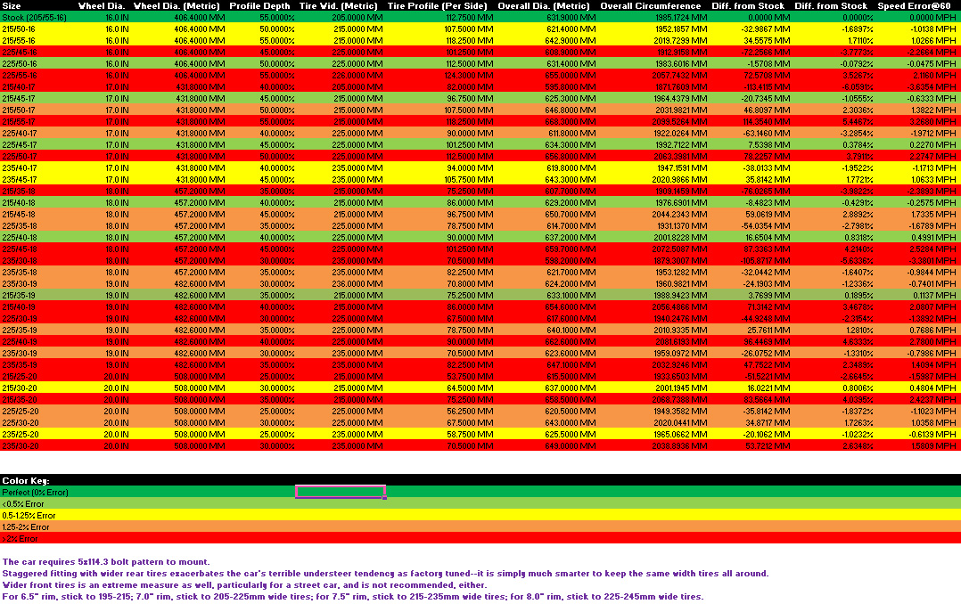

Use this chart to figure out the optimal wheel and tire size you're going for:
You can also download a copy of the original spreadsheet with formulas to try out your own combinations by right-clicking here and saving the file to disk.
-Ed
EDIT: Fixed error in comments at the bottom from piggybacking off a chart for a different car.
5 Posts
Oops; forgot to update that when I updated the chart (worked off of my tC chart)
I'll fix it to indicate 114.3 and upload it again. Thanks for identifying the error--applaud for you!
-Ed
5 Posts
I've added 19- and 20-inch tire sizes to the chart and cleaned it up by removing references to rim width. this should serve those interested in larger diameters.
I don't recommend 19s or especially 20s on this car, but hey, whatever floats your boat...
-Ed
2,202 Posts
I am having a bit of a hard time understanding that chart. So my question is this, what offset would I need to run 9.5" wide wheels on the xB?
I have 9" wide on the rear of my Jetta. I actually wish they were 9" all around but that wasn't a choice at the time. I probably could be happy with 8.5" but wanna see if 9.5" will work. I love wider tires, it does help out the handling and stance.
