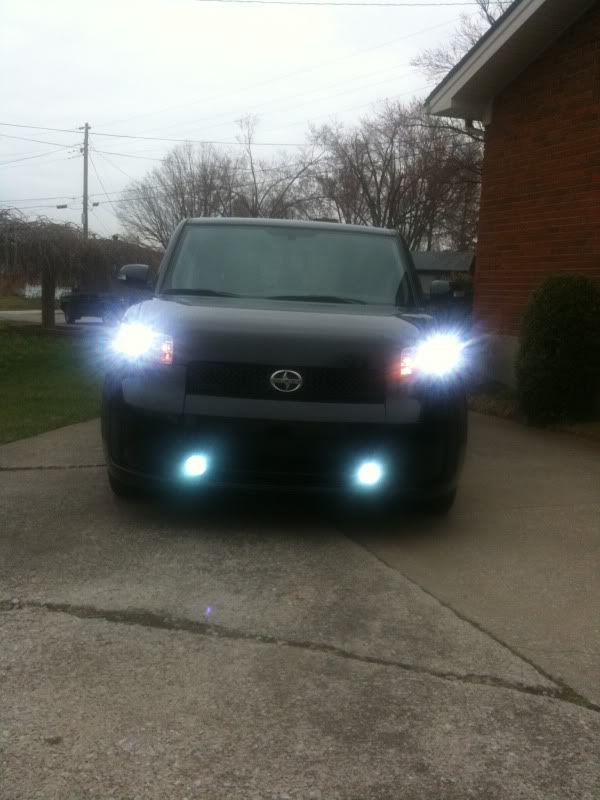

Here's a daytime shot. Both HID sets are 6000's! Only took about an hour and a half to do both.
That looks real nice!
Thanks for the picture and the idea!
not a problem!
