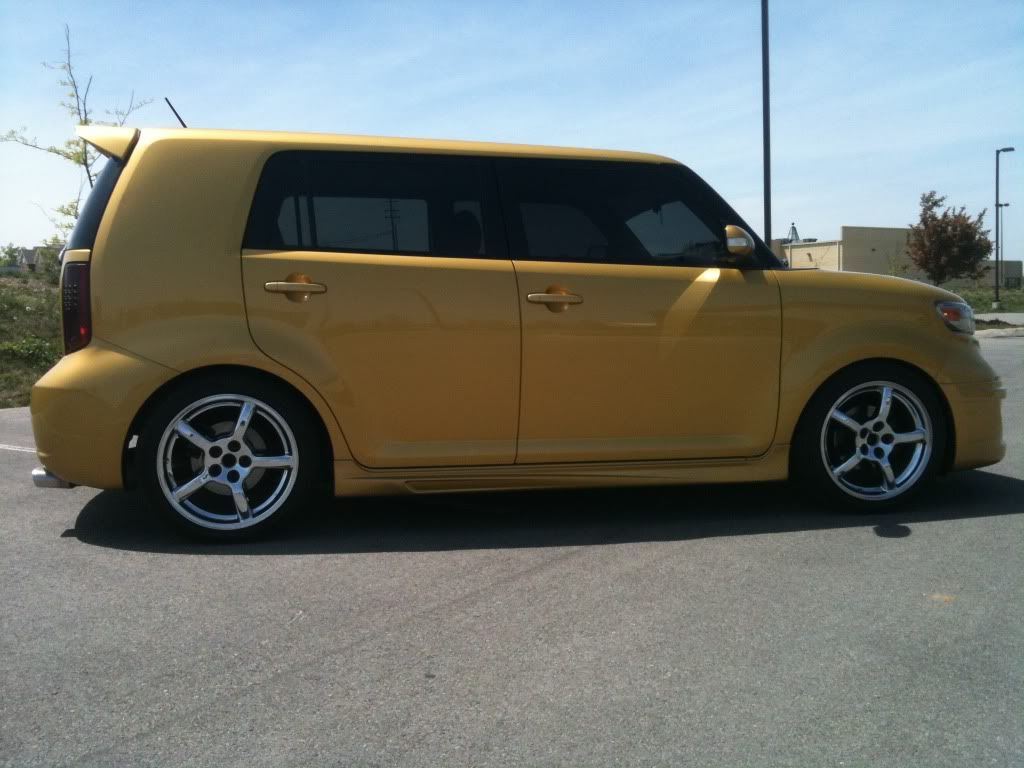

to get an idea, this is my xB with my chrome Z wheels, Some guy walked up to me and offered me $650 for the wheels, so how could I refuse :)
