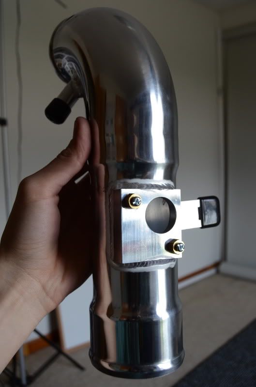

Update: The intake just arrived before I left for class!
The intake...wow.....it looks leaps and bounds better than I expected it to for $75.00. It actually looks on par with the tenzo R I saw on a friends xb2.
After inspecting the piece, the filter is similar to the cone filters you can pick up at autozone. The "air turbine" is attached to the inside of the filter, and after tinkering with it, I am just going to leave it on(dont feel like breaking something on a brand new piece).
Here are the obligatory pictures! (more to come once installed, plus a video of intake noise, and change in exhaust).
First impressions on ebay cold air intake. I was skeptical of the small plastic piece to "direct" airflow at first, but after looking, each blade is no thicker than a guitar pick. It really doesn't seem to inhibit airflow at all.
