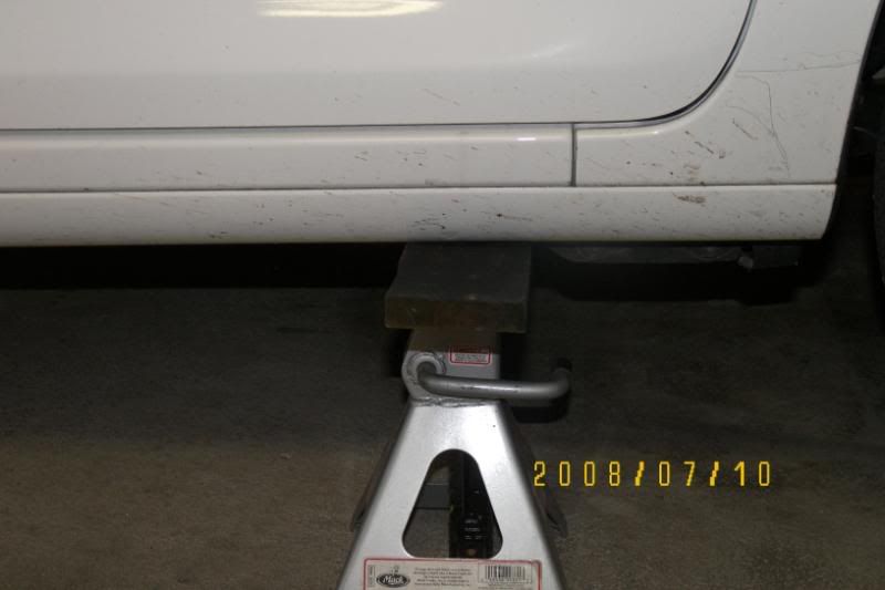

I then jacked up the front of the car with a floor jack at the jack point under the front of the car. Because I did not feel comfortable crawling around under the car with it resting solely on the jack I placed jack stands at the jack points on each side of the front of the car. I used a block of wood on top of the jack stands because I was afraid the jack stand might damage the underside of the car. This is one of the point I probably wouldn't do again. I would use ramps if you have them or get some before you change your oil. If you do this make sure you have some solid wood. If there is any chance that wood or is rotten or is not a hard wood do not use it. Here is a pic of how mine:
You can see how close the body is to touching the wood. I watched to make sure as I lowered the car down to make sure it wasnt going to touch. DO NOT LET THE CAR DOWN FAST! I left the jack under the front just to give it some extra support. I may try to make something to go over the jack stand so that I would feel more comfortable about the jack points resting on the jack stand but will probably get ramps instead before I change the oil again.

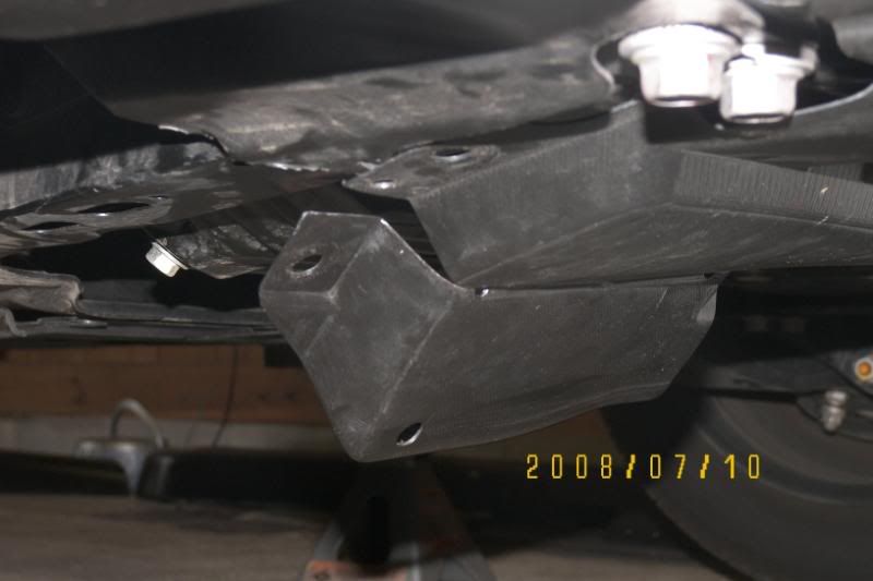

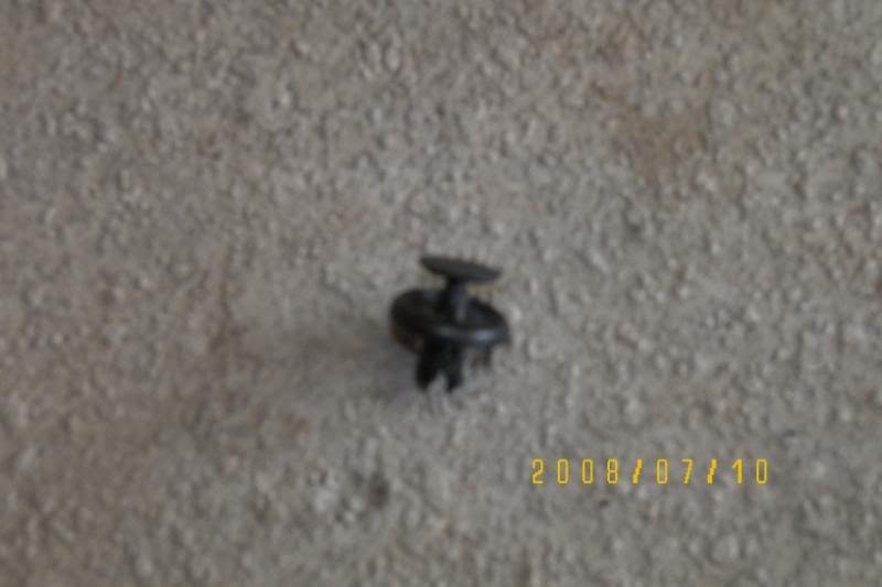

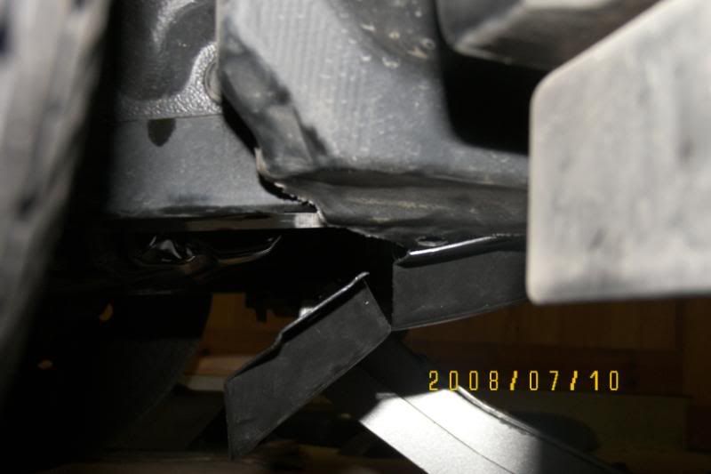

Next I removed three pins that are holding the shield in place below the oil filter. This was simple. All you have to do is pry out the center of the pin just a bit and then pull the pin assembly out.
I then just pulled the shield down a bit. It looks as though it was made to bend down but I was careful not to get to carried away with trying to bend it.

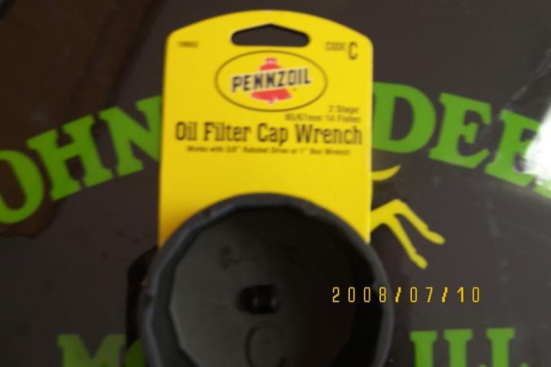

I then attempted to get the filter off with one of the metal filter wrenches that wrap around the filter. It was a very tight fit and didn't really have the room to get in there and turn it. The filter was on very tight! So I went to the local O'reileys and picked up the filter wrench that attaches to a socket wrench. I highly recommend getting one of these. It only cost around $6 and is very worth it.
Did I say the filter was on very tight? I had to put a paper towel inside this filter wrench to keep the wrench from spinning around the filter it was on there so tight. I don't think I have ever seen a filter that was tightened that much.

Putting the filter back on was a snap and then I buttoned the shield back up. Just push the pins back in place making sure the center pin locks into the outer pin as you push them back in.
