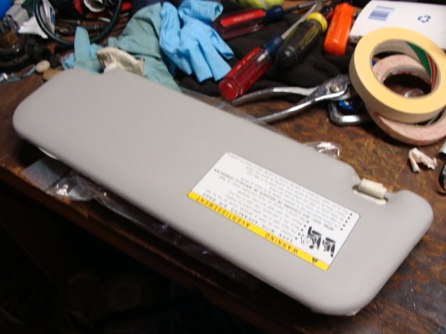

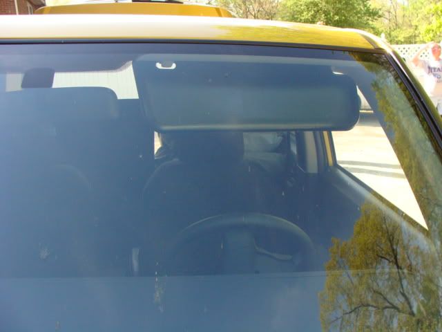

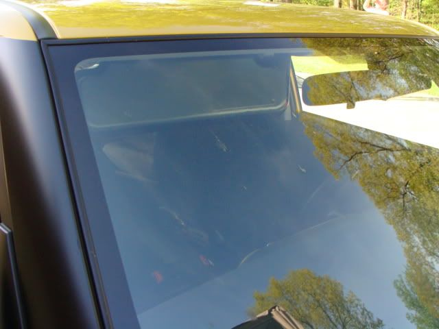

Wow I was just thinking about doing that today! What type of paint did you use and can we see a close up of how it turned out? Looks good though!
Much improved.

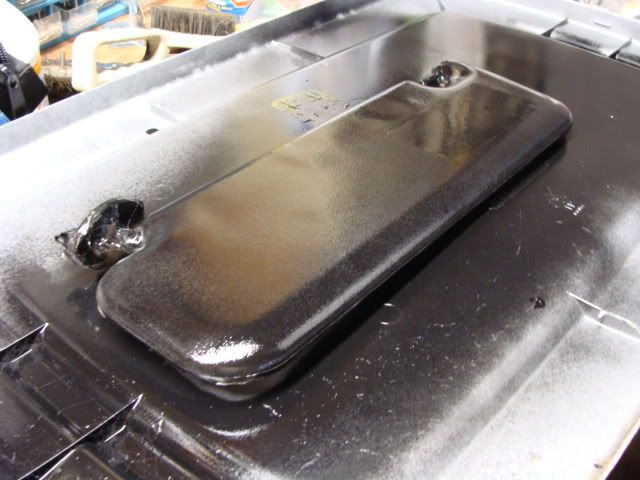

Looks good! So it's still fairly flexible? I'd be afraid of it being somewhat brittle, but the Fusion is made specifically for plastics. Should hold up!
Another option would be SEM's vinyl dye. I've been planning on hitting all of my stuff with that product when the headliner comes out for covering.

the paint adhered well, ive had no problems with the visors yet? 1 thing though , they take 4 ever to dry so be very PATIENT with them 2-3 days time and they will show fingerprints if touched to early
