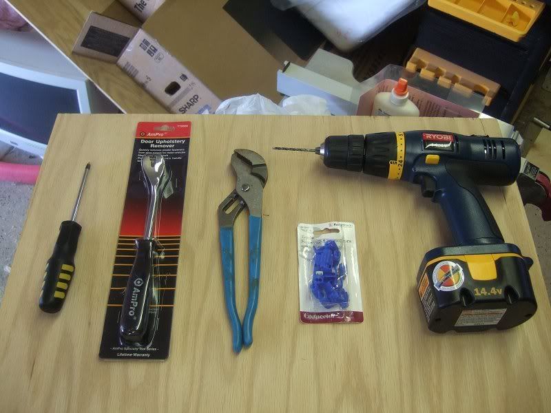

Accessories You Will Need:
Speaker Adapters -> Provide mounting holes for the large holes in the door. You can buy these, make these or your speakers may come with these like mine did. Available from Crutchfield for free with any speaker purchase or a local car stereo dealer. You can also make some from 1/4" plywood (which is what I did until I found adapters in the speaker boxes. :dontgetit
Wire Taps -> These will keep you from having to cut the existing wiring, running new wiring or soldering leads on. You have to run new speaker wire if installing an amplifier, but not if you use the existing head unit only. Available at Radio Shack, Home Depot, etc.
Tools You Will Need:
Power Drill -> Used to drill out the rivets that secure the speakers.
Wire Taps
Philips Screwdriver
Pliers -> Used to crimp the wire taps
Panel (Upholstery) Popper -> Available at Autozone or other auto parts store. This lets you pop the panel off the door without destroying the connectors or where they attach to the panel.

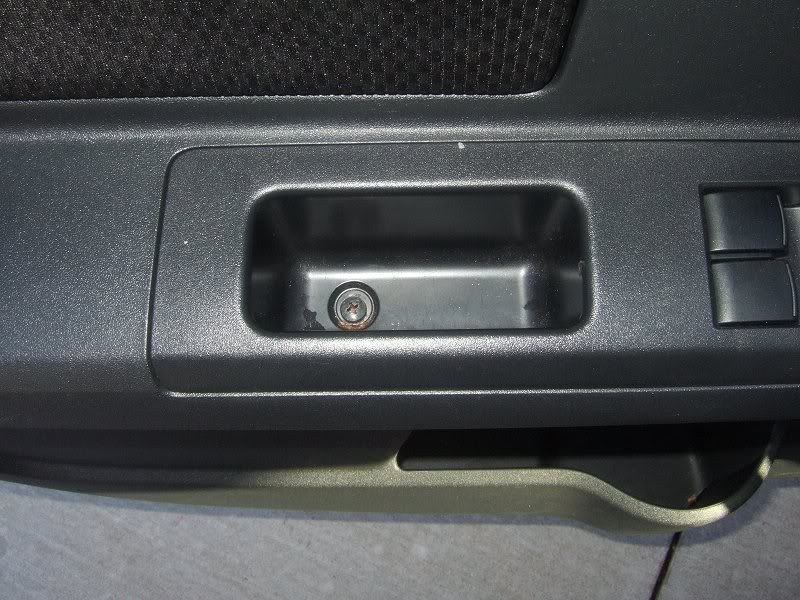

2. Pop off the cover in front of the door opening handle using the panel popper and remove the screw behind it

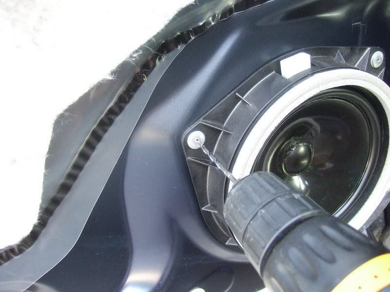

5. Next remove the speaker connector and drill out the rivets holding the original speaker in place. I think I used a 3/16" or 1/4" drill. In any case the rivet may spin so I twisted the drill around to force it to cut rivet and free the speaker. Be sure to pick up the back of the rivets from inside the door or they will rattle around. BE CAREFUL AS THEY MAY STILL BE HOT.

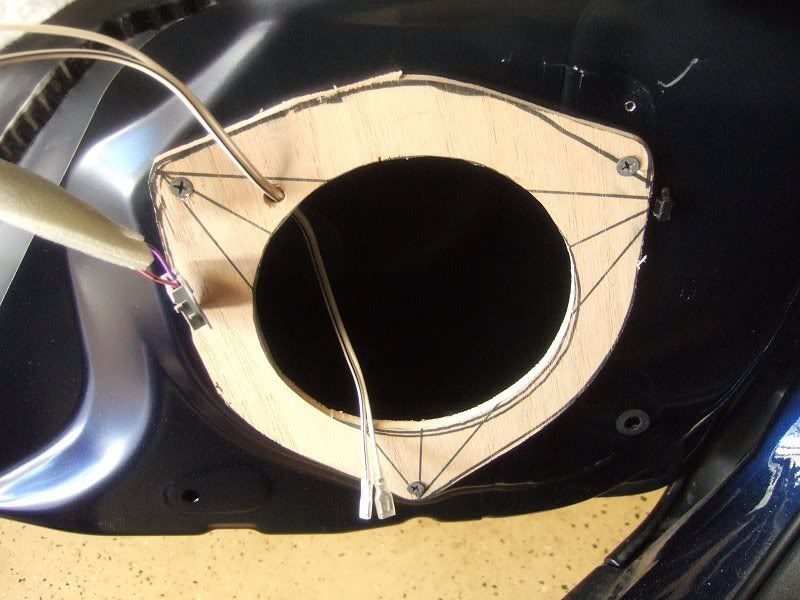

6. Next make or use a speaker adapter and attach it to the car. I probably won't match the speaker holes so you will have to drill new holes. Be sure to think about how you want to run the wires to the new speakers.

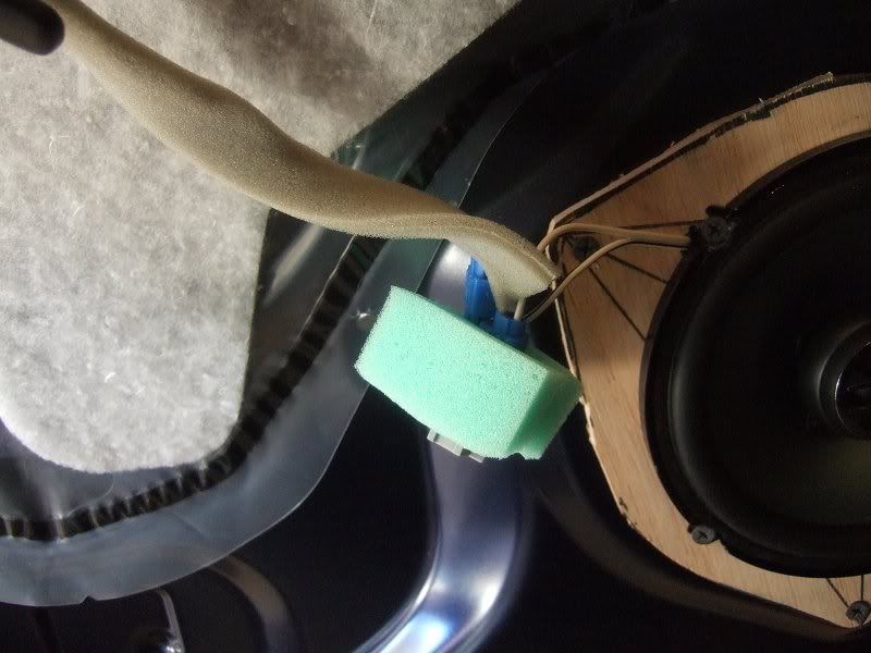

7. Once wiring is tapped and run, install the speaker. To make sure the new wiretaps don't rattle, cover them in some foam.
