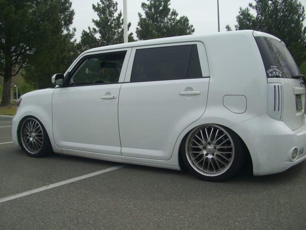

I like the stance on the silver one.

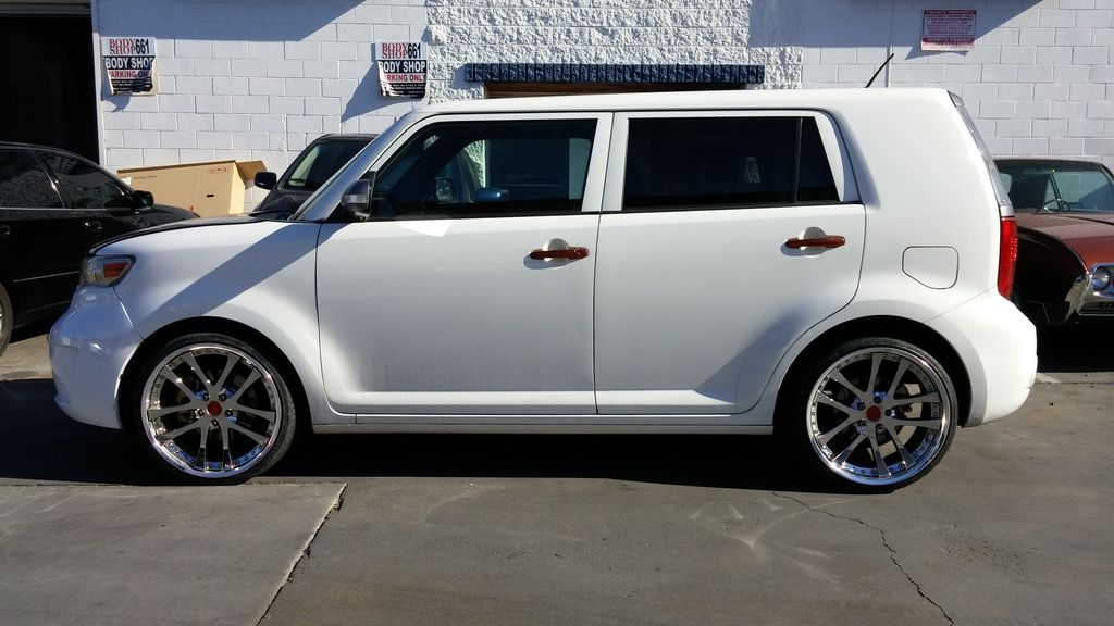

From your second picture I assume you are looking at bigger wheels than 16". The bigger the wheel, the more weight (larger diameter needs more metal), and also cost (bigger wheels and tires tend to be more expensive). Also a bigger wheel will have a shorter tire sidewall to go with it, so cornering is improved slightly but ride degrades because the tire is less compliant.
The best compromise between ride and looks is probably 18" wheels that are 7" or 8" wide, but of course that depends on your personal preference. A number of folks on this forum are running 18" wheels with no clearance issues.
That said, your second picture appears to have 19" wheels, judging from the short sidewalls.

Like BrickPig said there are a lot of choices for what you can go with in terms of tire and wheel packages. I will disagree on the pictured wheels though. They look to be 18s to me, too much rubber for 19s. Actually looking at them they look to be Falken wheels with spacers behind them. I had a set for a bit. They are 18 x 7.5 +42
