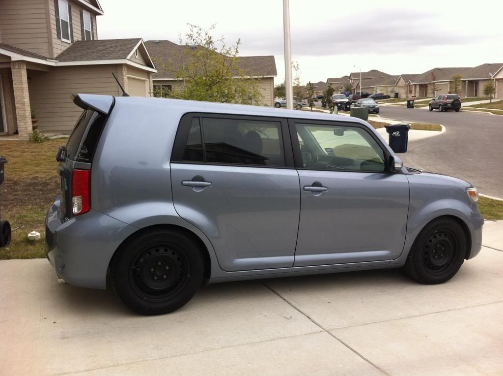

I know this is a little late. Sorry about the delay. Haven't been on the forums in a while. Here are some pics of mine with 205/65/16's on stock steel.

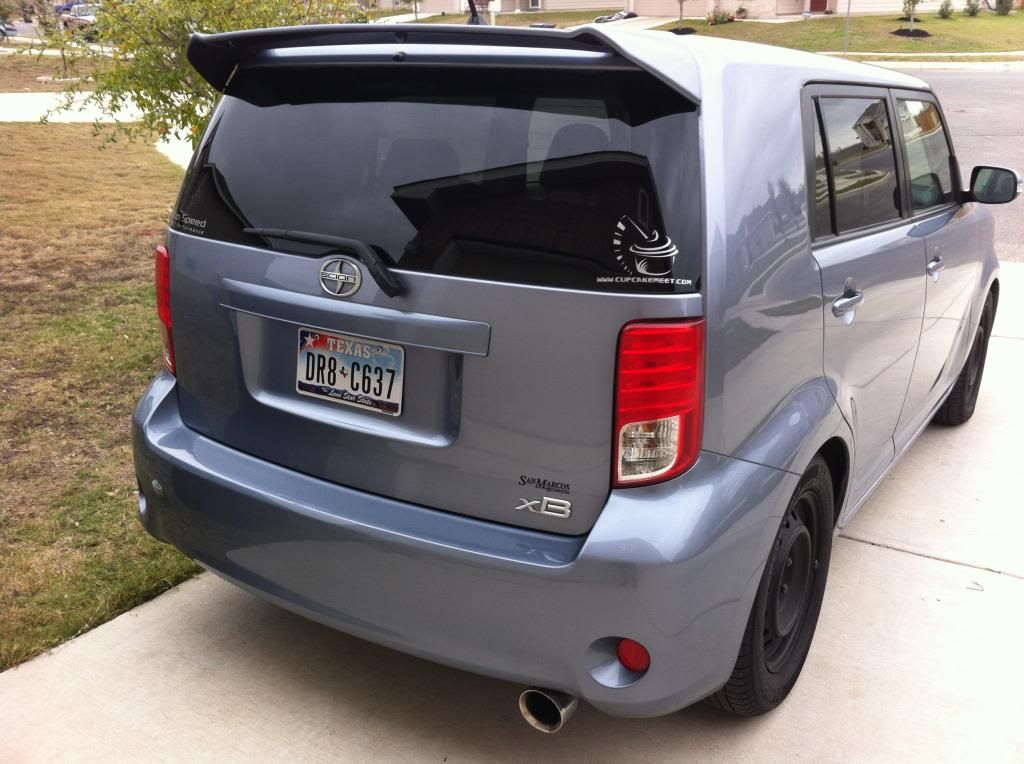

....And a more recent one to show where I am on it. Sorry bout the dirty state.
