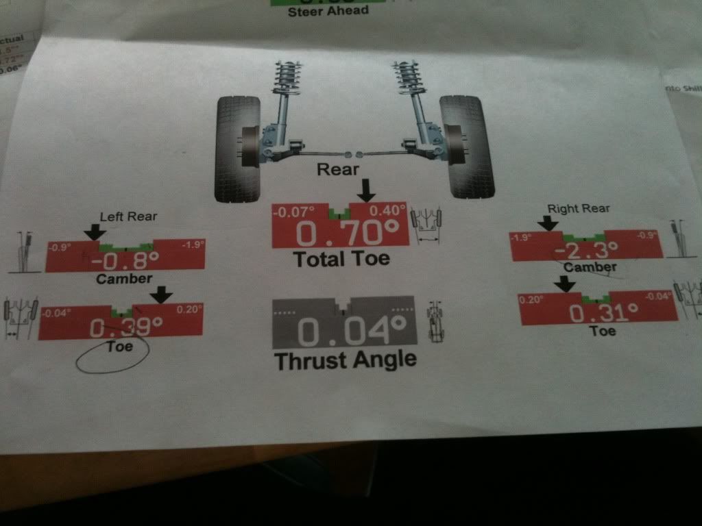

Hey guys, I recently installed the tanabe DF210's.
Then I got an alignment, and all hell broke loose.
The aftermath:
If anyone can help me out please tell me ASAP! I have No idea what I should do in the rear!!

I Guess the only real thing to say to you is raise it back to stock. With everything you mod there will be consequences. Is this the first car you have ever lowered? Alignments help but not sure about the rear??? Wait till you throw air suspension on it then check the alignment specs.... :rofl: :rofl:
2,526 Posts
DAMN! Thats a lot of fucking camber on 1 wheel haha.
ok, this is what you need to do, jack the *** end back up and check to see if the springs are "facing" the same way. As in, can you see the DF210 writing on one and not the other?
this might be why this is happening. If the springs are not going the same direction, then **** might not line up.
also, make sure 1 isnt upside down. and make sure you have that rubber thingy on the top of it.
good luck man.

However, alignment on these cars only help the front toe, nothing else.
OP -- If you go for the max drop (DF210 or ilk), you can expect some major misses in camber and rear toe, goes with the territory. Fortunately, you can get front camber bolts nowadays, but that doesn't help with the rear.
