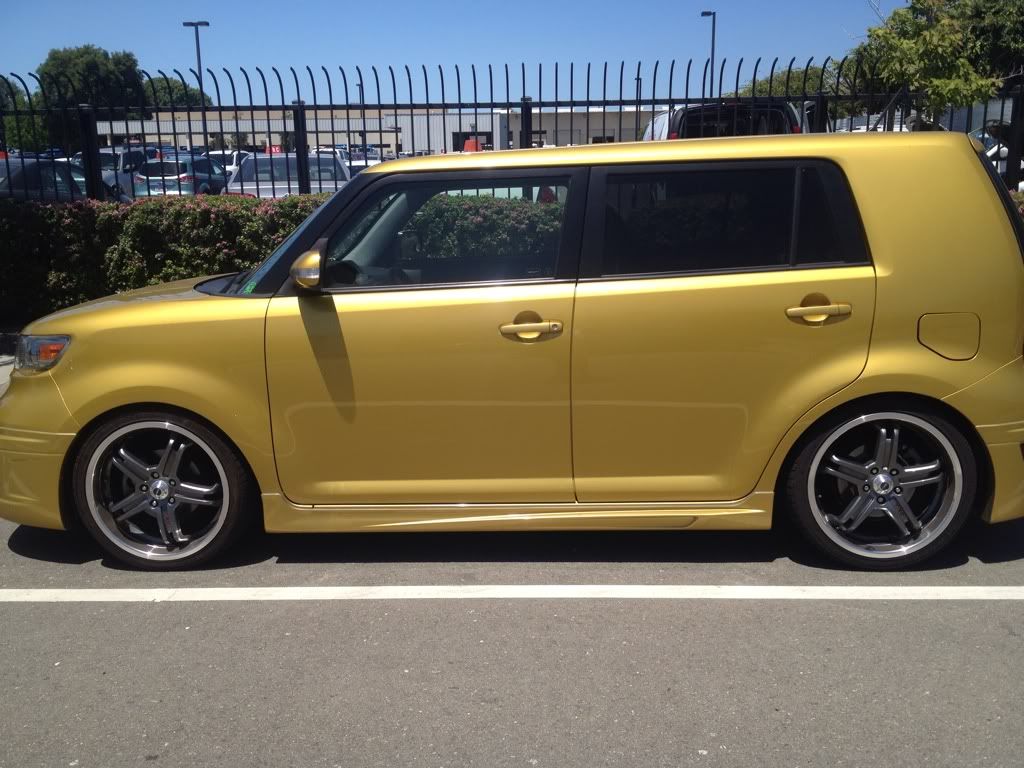

They have a pict on website of its stance, plus i have mine in my hello thread
ill try find it also
that looks sex jrules, did you have to roll the guards and do you have any issues with scrubbing etc?, thanks mate! They look good with your 19s :)
There is rubbing when I hit good holes or make a turn to fast and no no rolling fenders nothin. I am goin to be upgrading my shocks to tokiko hp blues tho when the stock ones go out.. But for the most part I love the ride not bouncy and all... Oh!!! Make sure to cute ur bump stop in half when u hang the springs cuz if not ull bottom out faster

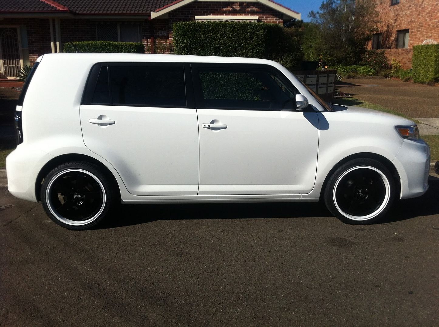

yeah, the road i take every day to work is a mess, ill buy the nf's and see how i go, i don't want to be on the floor, but enough to even it out and bring in the gaps.. this is it stock springs
3
