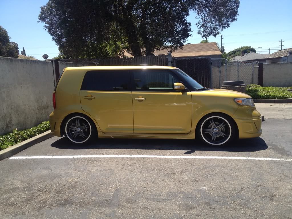

I'm running a 245 tires on 8" with a 45et wheels.

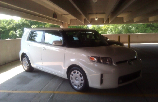

Tossing in a pic even though its just a stockie.

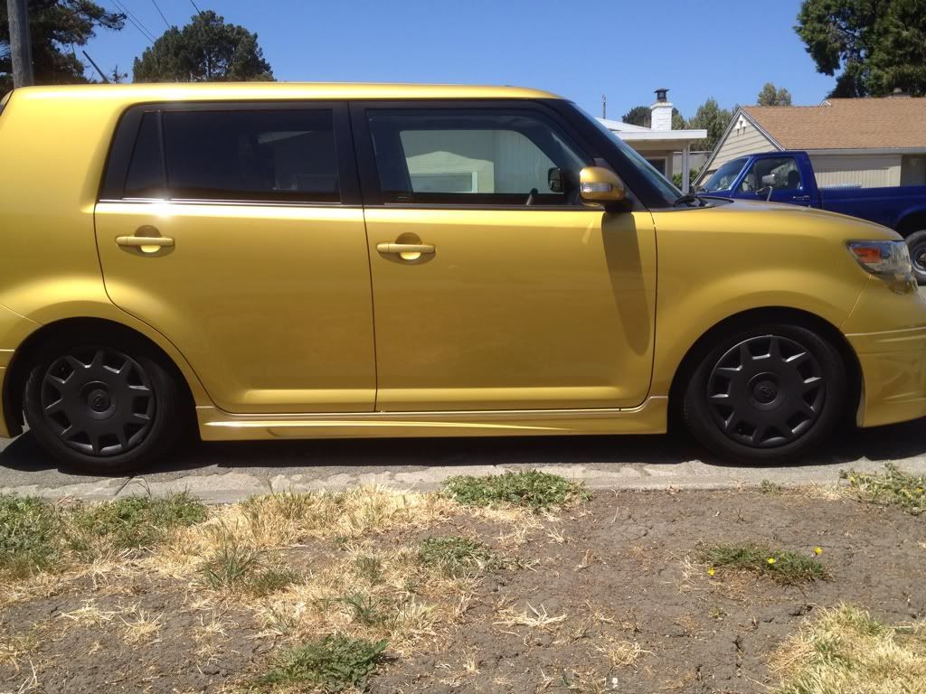

I'm running the df210 and love them a lot gets u low and it does seem to level u out here is a pic
What wheel and tire size are you running there jruless?
Right there Im running my Trd 19" wheels but I got a nail in one the tires so I just put back on my stock 16" wheels and it's lower now lol crazy right
